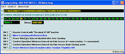

    Enabling/Disabling Auto Lock of the Rear Boot
    Tiguan VCDS Coding Options-9-central-electronics-rear-lid-auto-lock-jpg
    Adding "Mirror Lowering on Reverse" to your MFD menu
    Note: Must have memory seat option fitted (but not offered in Australian Tigs)
    Tiguan VCDS Coding Options-9-central-electronics-mirror-lowering-reverse-jpg

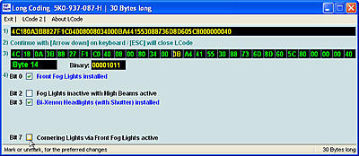

    Enabling/Disabling Fog & Park Lights Only as DRLs @ Bit 1 (manually type in a '1' in 2nd last digit of Binary Code)
    Enabling/Disabling Fogs as Cornering Lights @ Bit 7 (Left or Right Fog will turn on via steering wheel or indicator)
    Tiguan VCDS Coding Options-9-central-electronics-drl-fogs-only-active-jpg

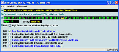

    Other DRL Options @ Byte 15 for those with no bi-xenons (e.g. Bit 6)
    Tiguan VCDS Coding Options-9-central-electronics-drl-byte-15-jpg

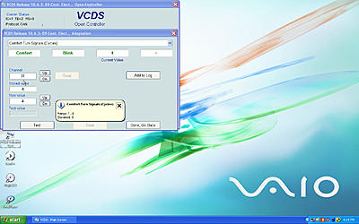

    Changing the number of Comfort Blinks (select from 1 to 5)
    Note: Need to click on 'Adaptation' button and then select 'Channel 31' to access below screen
    Tiguan VCDS Coding Options-9-central-electronics-channel-31-jpg

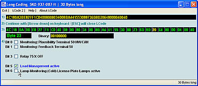

    Disable additional licence plate bulb monitoring @ Bit 6
    Note: Will get rid of the stubborn "bulb out warning light" received even with error-free LED bulbs

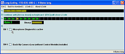

    MODULE 37 - Navigation: To enable and show RVC on display @ Byte 3, Bit 6
    Note: This only works for the low line camera (i.e. without the control module that gives you moving guidance lines)
    Tiguan VCDS Coding Options-37-navigation-enable-rvc-jpg
    Tiguan VCDS Coding Options-37-navigation-microphone-off-jpg

    Quote Originally Posted by Prodigy View Post
    Great work aussietig, very useful thread.
    Here, here. Am I right in assuming that if you activate the 'mirror lowering with reverse gear' that they will lower? I wouldn't have to change anything else? If so, that is a massive WIN!
    MY10 Tiguan 125TSI | Pearl Black | Manual | Comfort Pack | Kamei Eyelids | MDI | Not Leather | Rubber Floor Mats | Kids | Random Spillage | VWWatercooled Sticker | APR stage I | H & R springs | ECB nudge bar
    Oct 2009
    64
    Quote Originally Posted by Captain Bungers View Post
    Getting that mirror to lower is totally worth the price of the cable!! (But would prefer to borrow someone elses...)
    May 2009
    Perth, WA
    712
    It's just the passanger side mirror that will lower but yes, if you have the mirror adjustment knob to the left once you select reverse the mirror will lower automatically then return to it's normal position once in P or you drive off..I love it on the Golf.
    MY11 Golf R - Rising Blue - 5DR - DSG - 19" Black OZ Ultralegerra - Leather - Sunroof - MDI - Euro Plates - Milltek Exhaust - Bluefin - SOLD
    MY11 Tiguan 147 TSI - DSG - Pepper Grey - Black Leather - RVC - MDI - BT
    Jul 2010
    1,156
    Unfortunately coding has only enabled me to select it from the MFD.
    Still hasn't worked for me!
    Need people like prodigy who have a Golf with this Function working to provide VCDS scan.
    Comparing Golf's coding with ours will help confirm whether it's missing code or hardware that is needed for Tig to work.
    MY11 Tiguan 147TSI (SOLD)
