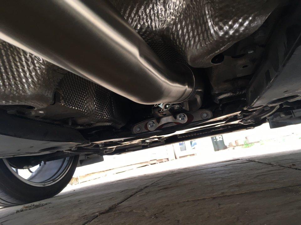

034 Motorsport Billet Aluminium MQB Dogbone Mount Insert
