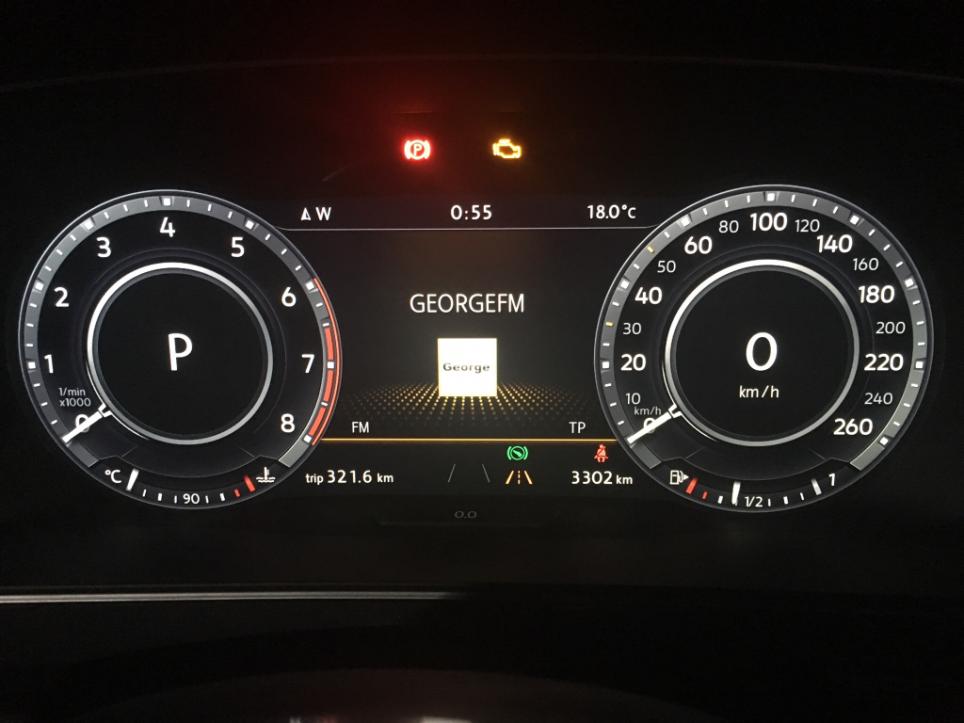

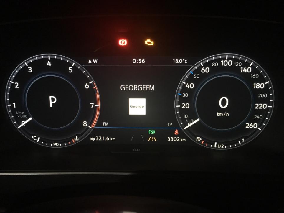

    Thought it was time that I finally get my act together and put up details for the tweaks that I have been doing with the Active Info Display as well as some other things I have found.
    These instructions are using OBDEleven but can also be achieved using VCDS as well.
    Go to Module 17 - Dash Board
    In Adaptation search for Display depiction
    Within this there are 4 Versions available.
    The default is Version 1 and as far as I can tell Version 2 is identical.
    Version 3 gives you the Gold display which I really like especially with the golden dots that bounce around when switching screens
    Version 4 is a more minimalist version of 1 (and 2)
    I really like the golden one however it just doesn't match the blue colouring within the Infotainment system. I have tried to see if there is an option to have the same gold colour but so far no luck. Because of this I am currently running Version 4 as I like the cleaner more minimalist look of this one.
    The only colour changes I have managed to make is to change the absolute bottom line from blue to white.
    Go to Module 5F - Information Control Unit
    Coding
    byte_17_Skinning
    The default value is Skin_1
    Skin_2 gives you the white line at the bottom as well as white box around the FM Station logos:
    Skin_3 and no_Skin looks the same as Skin_1
