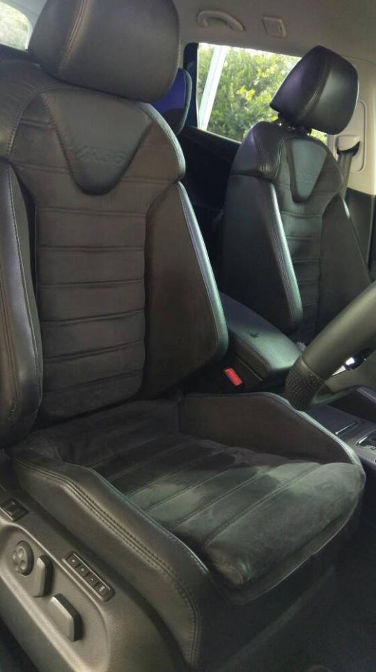

    Tonight I replaced the collapsed seat foam in my driver's seat. Was a bigger job than I thought but I had a friend help me.
    Tips - move the seat back all the way forward and seat angled all the way up to ease access to the cover for removal and insertion.
    - remove baby seats from behind to aid in giving room to remove the seat
    - the seat is easier still to maneuver if you remove the steering wheel (which I decided to do as I wanted to fix my ESCL wiring anyway)
    The seat now feels brand new. I have to now be careful to exit and enter as much as possible without too much weight on the bolster to get this one to last as long as possible.

  7. #177
    4,079
    Front seat out and steering wheel off (optional)
    New seat cushion
    Finished and back in. Brand new!
