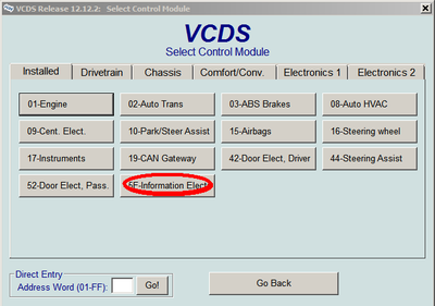

    Enable" Traffic" button on Mk7 Golf - VCDS tweak
    Enable Traffic Information (TMC) on Mk7 Golf - VCDS tweak
    Step 1. On "Select Control Module" option click "Select"
    Step 2. Select "5F-information Elect"
    Step 3. Select "Adaptation"
    Step 4. Using pull-down menu, select "Fee Based Traffic Information (TMC)" channel (it's about 20% down the channel list)
    Step 5 Change default value "0" to ?????
    Edit (30/04/2015): The magic number for Step 5 is apparently "1024".
    This value was initially suggested in sucnip's post below (see #55)
    And the value was confirmed in alanzidan's post below (see #48 - tweak 5.1)
    The remaining steps in the procedure are:
    Step 5. Enter "1024" into "New Value" box and click "Do It!" tab. (edit: I have seen the code "32771" used in UK models in this adaptation channel)
    Step 6. Click the "Yes" tab in the "Re-code Invalid" screen.
    Step 7. When the screen in Step 5 returns, click "Add to log" to record a copy of the change report.
    Step 8. Click "Go Back" (in Step 5 screen) and exit the VCDS software
    Missing Adaptation channel - Fix
    The channel, Fee Based Traffic Information (TMC) in step (4) appears in the drop-down list if byte 13 of 5F-information Elect. controller has a coding value of hex09. If this channel does not appear, then byte 13 may need to be changed to this value. Byte 13, bit 3 needs to be set for RDS to be enabled as per the screen-shot below (thanks zloybob.):
    Finally, after the changes above have been made, it's a good idea (I think) to reset the infotainment unit as follows: Press the on/off button on the radio until the unit switches off and keep holding down the button until the unit switches on again
    Please note the following after the tweak has been completed:
    1. For TMC to work, "TP" and "RDS" need to be activated in the set-up menu for the radio
    2. It may take some time for the new facility to be established and for the initial set of traffic reports to be downloaded. In my case, the wait time was over an hour, but others have reported longer times.
