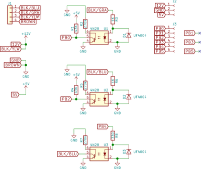

    Question
    Hi there!
    First of all, thank you very much Don for the circuit and other support on the forums!
    I have created my own version of the circuit (this is how I like to learn new things, and I just needed to understand it first). I also wanted the disabling functionality when going to the dealer, so I would have less explaining to do and I am quite lazy so I did not want to disconnect the module every time like wookie_666 .
    If anyone could verify my circuit, before I stick it into my car that would be great (I am not an EE and this is my first time making a circuit)
    I had changed the pinout, so the Don's circuit translates to this one as follows:
    P3 is now P0
    P2 is now P4
    The P0 pin is now sensing the SS switch state using a third optocoupler.
    I also have un-soldered the power led from the digispark and currently the peak current while the circuit is working is below 45mA and it drops to ~8-5mA while in the sleep state (not that it matters really).
    Since the code below enables the internal pull-ups on the unused pins, do not solder the unused pins to ground, since they will be high and you could damage your chip.

    The simplified flow diagram:
    (the above picture has an error, it should be SS LED lit? OR <5 pulses sent?)
    And the schematics:
    And the finished product (need to clean it up and isolate it):
  5. #145
    Hi guys,
    I am writing this third time, since I failed to see the big notice above about the requirement to post in the newbies corner first
    I have created my own version of the circuit (since this is the way a learn new things), that has the disabling capability for the module without the need to remove it before visiting the dealership (I do not like to take apart the interior). The idea is to keep the SS switch pressed for about 8 seconds after switching the ignition on.
    I changed the pinouts, so:
    P2 is now P4
    P3 is now P0
    and P2 is configured (using a third optocoupler) to sense the SS state for disabling purposes (of the module).
    If anyone could verify my circuit before I stuck it into my car and break something since I am an amateur, not an EE and this is my first circuit.
    Golf mk7: Auto Start/Stop disable switch - who wants to help?-flow-png
    (there is an error instead of SS LED is lit? AND <5 pulses sent? it should be: SS LED list? OR <5 pulses sent? also not disable module, but disable or enable module)
    Schematic:
    Golf mk7: Auto Start/Stop disable switch - who wants to help?-ssss-sch-png
    And the final build that still needs to be cleaned up and isolated:
    Golf mk7: Auto Start/Stop disable switch - who wants to help?-fin-jpg
    And the code (take care, since pullups are enabled on the unused pins so do not short them to ground):

    ^^^ hmm.............. looks liked a very good modification to my original design - well done and congratulations!!!!
    Still trying to understand your design, but it appears that you have stuck-with a Digispark (rather than the Pro). And I do like the "bye bye" pulses as a feedback to the driver!!
    My only concern is the workability of the input pulse to the PB2 ciruit (from the Blue/Black wire). It looks like you have used my original 1K resistor to ballast the current to the LED in the opto-coupler. My original assumption was that the internal circuit in the BCM ( to pin 60, Socket C) was some type of open collector logic signal. But if wookie's later advice is correct, the available voltage to drive the opto-coupler is just 2 Volts on the Blue/Black wire. As I said previously, this wire was designed by VW to be a low current input signal to the BCM, but both our circuits need this wire to drive an LED in an opto-coupler with sufficient current so that the gain in the photo-transistor changes state. Will 2 Volts be sufficient to do this? Again as I said, I suspect that some sort of low voltage, low current ciruit is needed (FET device?), but I'm not sure!!
    But a very good job!!!
  7. #147

    first, you will need to make sure how the SS disable button on your car is wired. On the RoW mk7s that are sold down here in the deep south, one side of the SS disable button on the center console is earthed. But I'm not sure how the SS disable button on an Italian market "Skoda Octavia Scout 4x4 184cv dsg with Columbus" is wired.

    Octavia RoW has exactly the same pinout used in Golf (minus version, earthed). I used for a while a copy of this circuit born2bastel >> Start-Stop Automatik deaktivieren mit Memoryfunktion, which stopped working at the beginning of our summer (poor construction quality maybe)
