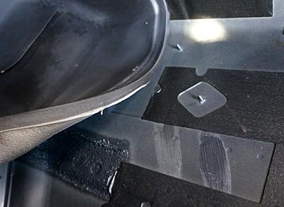

    Dynamat Extremed my boot on the weekend. Did complete coverage of the whole floor, spare wheel well and wheel arches, quite a lot of the panelling behind the boot side panels (maybe 40-50%) and the rear panelling under the tailgate. Also about half the width of under the rear seats (so far). Haven't done the tailgate.
    Used 8.5 sheets! I reckon if you only did the 25-30% coverage you might get away with one 9 sheet pack for a whole car, but for the sort of coverage I did needs at least 2 packs, if not 3 if you're also doing the doors. What I got was the older black (with silver logo's) stuff and it's really hard to see things on it so get the sliver, if not a different brand that doesn't feel the need to plaster their logo all over it.
    Here's some photo's showing the stripped car with just the factory applied sound deadening, how much Dynamat I put in (and how terrible it is to find things dropped on it), The rear door speakers and door undressed.

    A few tips - Apply sheets from a centre line down the car, not from one side to the other. That way it's symetrical and once you've cut a sheet from one side it's easier to work out how to cut the mirror side one. For a really neat finish use the Dynamat finish tape on joins since the edges of the sheets ooze butyl and it gets on your clothes when you kneel on it. I used one roll just in the boot.
    I did each of the 7 sections of the spare wheel well walls with a seperate panel of Dynamat as there is a compound curve at the top edge. I only left the central bit (about 50mm in diameter) of the spare wheel well free of Dynamat.

    After Dynamat Extreme. I went for pretty much complete coverage, but apparently you get close with 30%, as it's not so much noise blocking as vibration absorbing.
    For noise blocking the heavier Dynapad is best and that really needs to be laid over the whole surface to work. It is 1/2" thick though, not peel and stick, or as flexible as Dynamat Extreme and Dynalayer and weighs 1 pound per square foot (don't know what that is per square metre).
