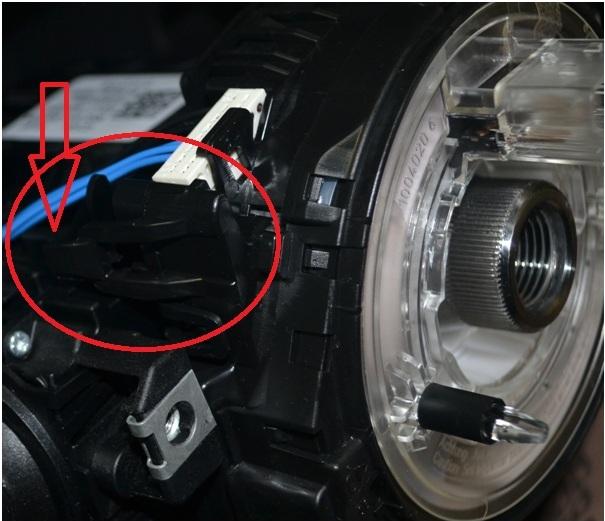

    Installing Wiring Harness
    1. Take a photo of the old wiring harness installed before removing anything, the new one is very similar just with one extra connector for the steering wheel buttons.
    2. Make sure you follow the same routing as the old harness, the airbag wire goes behind one of the springs. The springs can just be pulled out and put back easily to fit the new one. (I didn't take a pic of the new one, but looks very much the same as the old one did)

    Old:
    New:
    Note- You will have warning lights and loss of functionality until you code the new module via VCDS. Will update this thread once final coding is completed.
