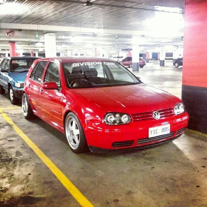

    Car: GTI FWD
    Front: 17x7.5 et18 after 20mm adapter
    Rear: 17x8.5 et18 after 20mm adapter
    205/45/17 nankang ns20
    Haven't measured arch height
    Fenders rolled: no
    Fenders pulled: no
