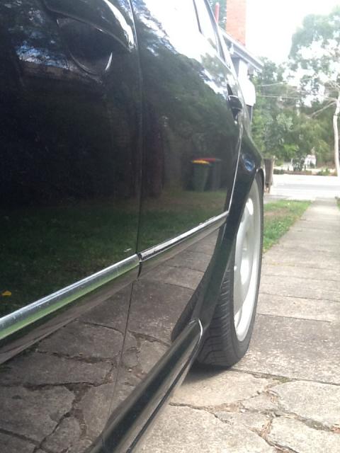

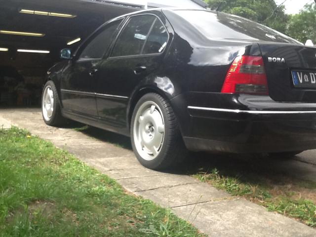

    7,501
    Iv done two to show the difference between heights and how much difference it can make even over a 2.5-3" drop
    excuse the photos. measurements were taken on level ground, not enough room to take pictures there.
    Car: Bora FWD 2lt, aired out
    Front: 17x7.5et30 215/45/17 good year
    Rear: 17x7.5et30 215/45/17 pirelli
    Arch height to ground Front: 21.75"
    Arch height to ground Rear: 22"
    Fenders Rolled: Front only
    Fenders Pulled: No
    Camber: Front 1deg, but due to being pulled from the bottom it makes offsets more aggressive (approx the same as running a 10mm spacer/ 1deg extra in rear
    Car: Bora FWD 2lt, approx ride height
    Arch height to ground Front: 24.5"
    Arch height to ground Rear: 25"
    Fenders Pulled: No
    as you can see front cambers out, but sucks in the lower it goes
    Rear stays about the same due to the fixed beam, it just rolls forward into the guards
    Bora gone
    Vento VR6
    MKIV GSW TDI
    7P Touareg TDI
