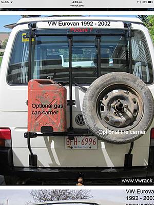

    Just wondering if anyone has any experience with a Tyre/Jerrycan holder on the tailgate. Either the one adapted using VW's bike carrier or custom made. Like these photos.

    Great idea for keeping an extra spare but one big thing to make sure of is the struts will probably not hold the weight so you may need to get stronger ones .

    I don't think a bike holder would be strong enough for a rim and tire.. there is a fair bit of weight, it all depends on if the top of the frame can be reinforced and if the lower mounts are strong enough for the extra moment load on them

    Thanks for the suggestions. I like the idea of being able to open the tailgate without having to swing out a tyre carrier as well.
    Yes the gas struts definitely have to be upgraded.
    The second photo showing the one using that adjustable tie down track looks possible to make. I think the track is held to the door with nutsurts and adhesive. It looks very neat.
    This one is Canadian and is made by Gary Lee for the T4 tailgate. May be able to be modified for the T5. The swing-out versions he makes for the T3 are really well made.
