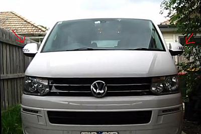

    Hi team! I want to fit a pair of side mirror covers to a T5.2 (2011) which have integrated yellow turn indicator signal lights, like this: (Link to item on eBay)
    I'm going to get the indicator signals from the BCM, see post below. It's part number is 7H0 937 087 F. and the wiring diagram/pinout is below (note the wire colours are not accurate because it's for a Polo, but the pins are the same.)
    Then I'll go ahead with the mod (I've already got the door trims off) and post pics for y'all
    T5.2 2011 Mirror INDICATORS and PUDDLE LIGHTS-jpg T5.2 2011 Mirror INDICATORS and PUDDLE LIGHTS-off-jpg

    Mirror indicators and puddle lights fitted
    I installed the turn signal indicators and puddle lights in the mirror housings of the folding mirrors. See here for more details on the folding mirrors.
    The indicators:
    T5.2 2011 Mirror INDICATORS and PUDDLE LIGHTS-img_0101-001-jpg
    Indicators with the puddle lights on:
    T5.2 2011 Mirror INDICATORS and PUDDLE LIGHTS-img_0102-001-jpg
    The puddle lights are pretty effective!
    T5.2 2011 Mirror INDICATORS and PUDDLE LIGHTS-img_0104-001-jpg
    Look during the daytime:
    T5.2 2011 Mirror INDICATORS and PUDDLE LIGHTS-unfolded-jpg
    I used these Chinese Eagle eye LEDs from AliExpress. Initially I was going to use the LED BOLTs from Oznium in the USA but found these Chinese ones to be brighter, cheaper and better quality!
    T5.2 2011 Mirror INDICATORS and PUDDLE LIGHTS-eagle-eye-jpg
    Link to the lights on Aliexpress, click here
    NB I also have puddle and warning lights in the door cards.
